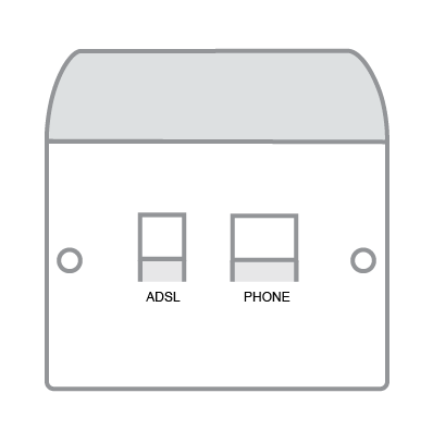

Non Nte Master Socket Non Nte Master Socket
Non NTE

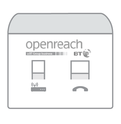

Nte 5 Master Socket Nte 5 Master Socket
NTE 5
 Nte 5c Master Socket Nte 5c Master Socket
NTE 5C

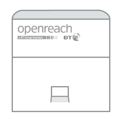

FTTC Master Socket FTTC Master Socket
FTTC

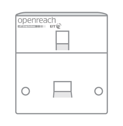

Nte 200 Master Socket Nte 200 Master Socket
NTE 2000
Nte 5c mk4 Master Socket Nte 5c mk4 Master Socket
NTE 5C MK 4
